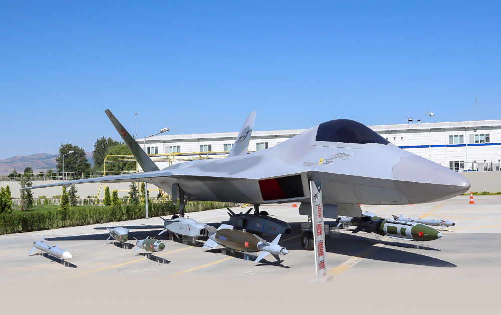

Unveiled for the first time via a full-sized mock-up (which was constructed by Turkish Aerospace-KALAY Joint Venture Company in Germany within 35 months, cost the company almost Euro2 Million [US$2.25 Million]) during the Paris Air Show(PAS) on June 17, 2019 and later in September 2019 at the Teknofest Istanbul, Turkey’s next generation National Combat Aircraft (abbreviated as MMU in Turkish), also known as TF-X, will replace the F-4E 2020 Phantom IIs and F-16C/D Fighting Falcon combat aircraft currently in the service of the Turkish Air Force (TurAF)during the first quarter of the 2030s.
Featuring Low Observability and Supercruise capabilities and to be equipped with domestically developed systems and sensors, the MMU/TF-X will be a 5th Generation indigenous air superiority fighter with secondary ground attack capability. The TurAF currently operates some 30 F-4E 2020s (which were planned to be replaced by F-35As and to be phased out of TurAF service in 2020 but now expected to remain in the service until 2025) and 238 F-16C/D aircraft and Turkey is likely to procure some 150 to 200 TF-Xs in the long term to replace F-4E 2020s and F-16s. Since the F-16C/D combat aircraft, that forms the backbone of TurAF’s airpower, will be deactivated from the service starting from 2030 (Block 30 and Block 40 versions) and the deliveries of F-35As (procurement of up to 110 aircraft were planned) to TurAF has been halted by the US Government in 2019 the MMU/TF-X Program has became more important for the Turkey. In December 2019 the US Secretary of Defense has been authorized to fly up to 6 Turkish F-35As (tail numbers AT-01 to AT-06) to a storage location in the US and to induct these 6 aircraft into a long-term storage condition.
According to Turkish Fighter General Characteristics data that was released by Turkish Aerospace during Paris Air Show 2019, the aircraft would measure 21 meters in length, have a 14-meter wingspan, will be 6m in height, with a wing area of around 60sqm and a maximum takeoff weight (MTOW) of over 60,000lb (27,215kg+). To be powered by a pair of 27.000lb class indigenous turbofan engines (prototypes will be powered by a pair of F100-GE-129E engines, each generating 29.500lb of thrust) the TF-X is intended to have a maximum speed of Mach 1.8, a service ceiling of 55.000ft and a combat radius of 600 nautical miles carrying four beyond-visual-range (BVR) and two within-visual-range (WVR) air-to-air missiles and internal fuel. The TF-X will be capable of pulling negative 3Gs to positive 9Gs. In the light of this data in every aspect of size – height, weight, wingspan, weight – the TF-X is bigger than the existing 5th Generation fighters including F-22 Raptor, F-35 Lightning II, J-20A/B Mighty Dragon and KF-X. Nevertheless, the overall design of the TF-X mock-up bears similar features to the F-22 Raptor (such as twin-engine, fixed diverter inlets, Air Pressure Relief Doors on the back of fuselage, super cruise, Thrust Vector Control [TVC, either 2D or 3D, a round exhaust which is needed for 3D thrust vectoring reflects more radar energy back to the radar receiver than a rectangular (2D) one that the F-22 Raptor has], internal weapons bays and canted vertical tail design) and F-35 Lightning II JSF (internal weapons bays, Electro-Optical Targeting System [EOTS] and a Integrated Cockpit Display System) stealth fighters, but with a narrower and longer fuselage and wider wingspan.
Even if it will be an all-weather, multirole fighter the MMU/TF-X’s primary role would be air-superiority. Like the F-22 Raptor air superiority fighters the MMU/TF-X has both cheek and ventral internal weapons bays. The ventral internal weapon bay can hold up to four launchers for medium/long-range (BVR) air-to-air missiles and air-to-ground munitions and missiles weighing between 250lb to 2.000lb. Each cheek weapons bay, on the left and right of the fuselage, can hold two launchers for short-range (WVR) air-to-air missiles.
The MMU/TF-X will also have new generation features including Low Observability, High Maneuverability (to be better than F-16C), Internal Weapon Bays, External Weapon Carriage (for NATO and Indigenous weapons), Increased Situational Awareness, Interoperability with AEW&C aircraft, UCAVs and AARs, Super cruise, Advanced Avionics for Sensor Fusion (5th Generation avionics suit) and Independent Operation Capability (no need for other A/C). The aircraft will be equipped with an indigenously developed gallium-nitride (GaN) Active Electronically Scanned Array (AESA) Radar, Integrated Processing Computer (Mission Computer), Infrared Search and Track (IRST) System (in front of the cockpit), Integrated EW Suit, as well as a Integrated Electro-Optical Targeting System (which is abbreviated as BEOS in Turkish and will have a similar function as the Electro-Optical Targeting System [EOTS] on the F-35), Helmet Mounted Sight System (HMDS, there is no HUD at the cockpit) and an Integrated Cockpit Display System (panoramic cockpit display) like that on the F-35 Lightning II aircraft. Aselsan has been contracted to develop indigenous AESA Radar, BEOS, IRST System and EW Suit. Negotiations regarding the Integrated Cockpit Display System (panoramic cockpit display) and HMDS are currently on-going. TUBITAK, on the other hand, has been contracted for the development of the Integrated Processing Unit (IPU, a mission computer and abbreviated as BÜİT in Turkish). Within the scope of the MMU/TF-X Program, Aselsan also is developing Integrated RF System (abbreviated as BÜRFİS in Turkish) for the MMU/TF-X. The BÜRFİS Project aims to increase the Technology Readiness Level (TRL) by developing critical technology elements with national means such as:

First Piece of TF-X is Revealed: Air Inlets
Having spoken with C4 Defence on December 30, 2019 Turkish Aerospace President & CEO Temel KOTIL stated that Turkish Aerospace and TUBITAK BILGEM have started to work on the reflection of radar waves from the TF-X aircraft. KOTIL said, “We have started cutting the air inlets, we made the first air inlets. We began to work on their electromagnetic reflection with TUBITAK BILGEM. The first air intake is now at TUBITAK. We want to see whether the inlet is swallowing or reflecting the RF waves. We have started to analyze this and are physically hands-on in the process now. So, it's not just on paper anymore.”
Supplying the engines with the necessary quantity of air for generating thrust takes place by specially designed air inlets. The task of the air inlet is to supply the engine with a uniform, stable, low-loss flow. The air inlets come in a variety of shapes and sizes with the specifics usually dictated by the speed of the aircraft. One of the critical designs affecting the performance of the aircraft engine at subsonic, supersonic speeds and high angle of attack is the air inlet design of the aircraft. The geometric shape of the air inlet also closely concerns its reflection from the radar.
The MMU/TF-X will be fitted with a pair of Fixed-Shape Supersonic Inlets with stationary diverters (fixed diverter inlets). When the airframe design of the TF-X mock-up is examined closely, one of the first details that draws attention is that the air inlets are fixed as in the F-22 and there is a 3-4 inch gap between the fuselage and the air inlets, which aims to isolate boundary layer airflow. Just like the F-22, there are also Air Pressure Relief Doors on the back of the TF-X fuselage. The 5th Generation aircraft, such as the F-35 JSF, J-20 and FC-31, are usually fitted with Diverterless Supersonic Inlets (DSI). DSI type supersonic air inlets have better stealth ability than fixed diverter air inlets and are more efficient, but they have a performance limit that will not allow the aircraft equipped with them to exceed Mach 1.8 - Mach 2.1. The F-35 JSF is a multi-role combat aircraft, which is designed primarily for air-to-ground combat, so it doesn't need either to fly at high speeds or to have supercruise capability. Because of that, the F-35’s maximum speed is Mach 1.6. The F-22 and TF-X, on the other hand, are air superiority fighters (MMU/TF-X’s primary role would be air-superiority), which means they should be capable of flying at high speeds. It is believed that with the 29,000lb class indigenous turbofan engines the TF-X might exceed the speed limit of DSI type air inlets. So using DSI type air inlets on the aircraft would not be a good idea for the MMU/TF-X. Moreover, as in the case with the F-22, which could achieve Mach 1.5+ speeds without the use of afterburners (supercruise capability), the TF-X will also have supercruise capability.
