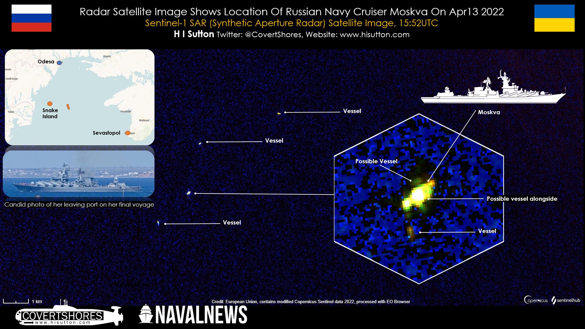

Thank you to @era_shield , this might be of good use for this thread too:
Satellite Image Pinpoints Russian Cruiser Moskva As She Burned
Satellite image shows Moskva sinking
Analysis of radar satellite imagery has revealed the location of the Moskva soon after she was reportedly hit by 2 missiles. The Russian Navy cruiser was the flagship of the Black Sea Fleet and is a symbolic as well as naval loss for Russia.
(continues here)
