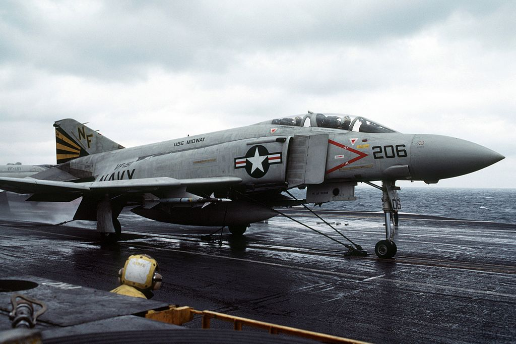

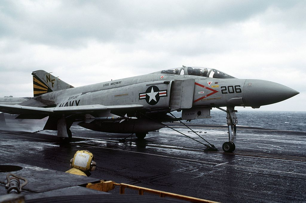

What about navalised f-4 phantom ?

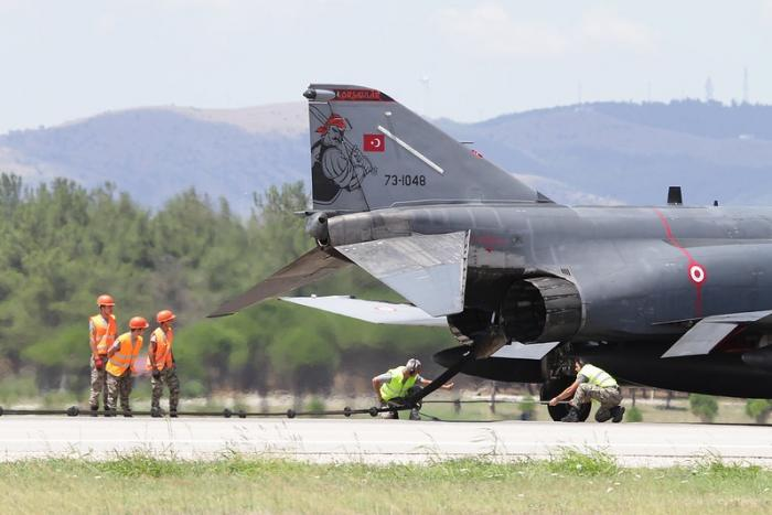

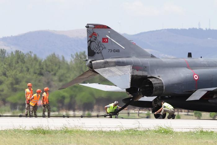

Just another example I found online of an indigenous catapult launch and arrestor system tested on the f-4E phantom
It is land based cable arrest system which is used in some airstrips and there wasn't a catapult test and it wasn't related to take off/landing systems of the ships, however it requires a stronger frame,which requires modification, in marine application because approach-landing windows is narrow and short, thus airplane should be caught and stopped in a short distance.
Beside this, an aircraft carrier is not just a ship which is carrying jets.
I expect that what is referred as " aircraft carrier" would be larger version of TCG Anadolu focusing only Light Aircraft Carrier configuration, optimized for those purposes.
